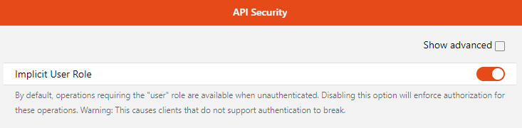

    2. Turn on Implicit User Role
    Check that the Implicit User Role is ON in your API Security settings (it most likely is).

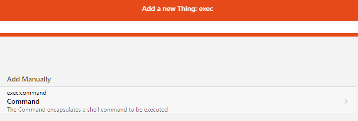

    1. In MainUI, manually add a thing using the Exec Binding. You can edit the ID and label to be whatever you want them to be (mine is called Post_Test_Command).[Blockierte Grafik: https://community-openhab-org.s3.dualstack.eu-central-1.amazonaws.com/optimized/3X/c/7/c778612c9533e25aff9f7c3becf8835d36083bd4_2_517x175.png]image722×245 6.01 KB
    2. Enter the following statement in the Command field, substituting in your myopenHAB username and password:
      curl -u username:password -H "Content-Type: text/plain" -X POST -d "Online" https://myopenhab.org/rest/items/myopenHAB_Connection
      This curl command changes the string in the myopenHAB_Connection item to be Online.
    3. Click the “Create thing” button to save your work.

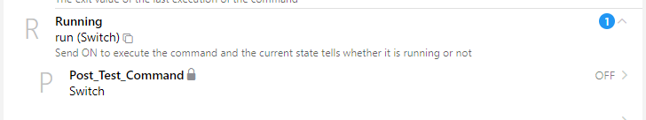

    4. Create a switch item that’s connected to the Running channel of your exec thing (I’ve called my item Post_Test_Command). When this item is turned ON, it will execute the shell command and then reset itself to OFF.[Blockierte Grafik: https://community-openhab-org.s3.dualstack.eu-central-1.amazonaws.com/original/3X/e/8/e8e19b7586511eb46a0a23036b631f4df53d81a8.png]image728×136 6.09 KB
