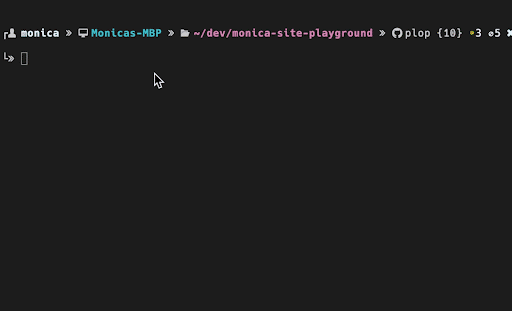

Have you ever copied and pasted the same boilerplate code for multiple files at once? I've found that when creating components, at a minimum, I generally have to create an assortment of files that may include: the index file, test files, related assets, related translations, README, storybook file, etc. Each of these files generally have to follow certain conventions in terms of how dates are formatted, the casing used for filenames, the component or function syntax, etc.
If you have strict conventions for how files should be named, structured, and organized in ways that can't be adequately captured by linting, then I recommend looking into whether automating file creation is worth your while. From my exploration, there are some relatively lightweight options, including automating file creation with PlopJS or using tools like Makefiles to conform to a predetermined template. As a contributor, I've found that I can more quickly contribute new components to an unfamiliar repository that has a generator for creating new components. There are some conventions and standards that can be baked into a template that otherwise would be difficult to capture without reading very detailed documentation or heavily referencing other components. Being able to run a command to auto-generate the files for a new component has allowed me to more quickly understand the conventions that are enforced in an unfamiliar project. These templates reduce the amount of copying and pasting involved in getting the 'Hello World' version of a component that follows all of the conventions ready, is more accurate than manually piecing together various conventions, and encourages more consistency of how various design patterns are implemented.
Gif of the author Monica's site playground running PlopJS to automate file creation.

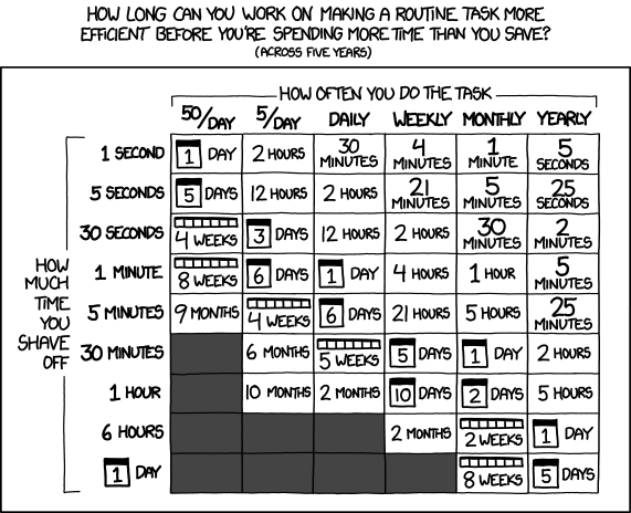

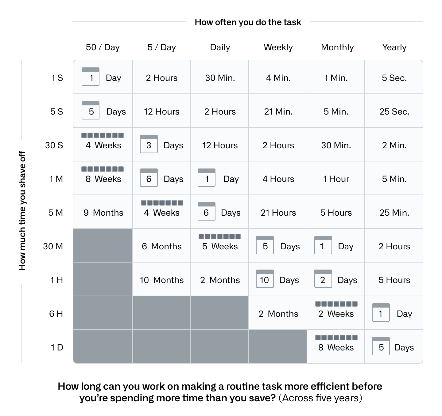

When exploring the introduction of templates to a project it is important to determine whether the template will actually save you time based on how often the task will need to be done, how long it will take to implement the automation, and how much maintenance the template may require overtime to ensure there is minimal drift between the template and the desired conventions. I found the PlopJS library, a micro-generator, to be a lightweight way to introduce templates that can be used within a project to create generated files. PlopJS is a combination of the Handlebars templating language and Inquirer.js for collecting user input. I wrote a more in-depth walkthrough of how and why I used plop to automate file creation.
Table shows how long you can work on making a routine task more efficient before you’re spending more time than you save across five years. For example: If you do a task 50 times a day, and it takes 1 second, it’s worth spending 1 day automating it.
This work is a derivitive of Is It Worth the Time? by xkcd and is licensed by CC BY-NC 2.5
